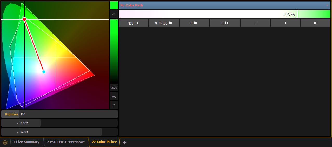

The color path display has a drop down list of the available paths, a color path preview bar, and control buttons. An indication line will display on the color space to show the color fade.
Available control buttons are:
  • - replays the color fade using the cue time.
  • - replays the color fade using the Go to Cue time from Setup.
  • - replays the color fade in five seconds.
  • - replays the color fade in ten seconds.
  • - pauses the color fade.
  • - plays / resumes the color fade.
  • - skips to the end of the color fade.
You can also click on the color path preview bar to scrub to any point along the fade.

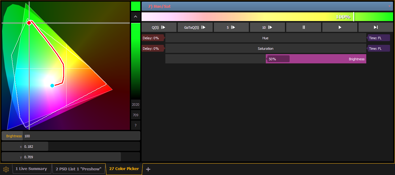

Additional controls may be available based on the color path selected. For example, Color Path 7 has additional controls for Hue, Saturation, and Brightness. You can move those controls to adjust the fade, and you'll see a representation of those changes in both the color path preview bar and in the color space.
Changes can be stored in the destination cue as absolute data by using [Update] or [Record]. When there's a change to the color path information, a red c will display next to the channel number and the color path's name will display in red in the color path display. When that data has been saved, a blue c will display. The color path's name will also display in blue in the color path display.
